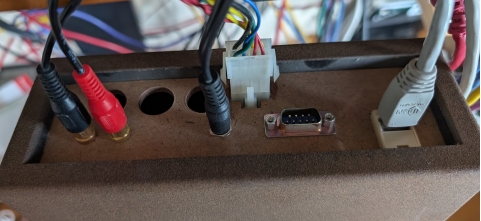

#374699 - Yesterday at 12:18 Re: Dock/Tuner [Re: Ladmo]
Posts: 14530
