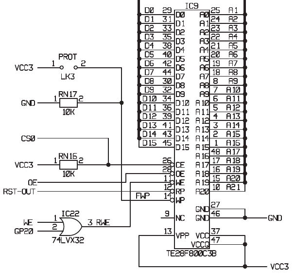

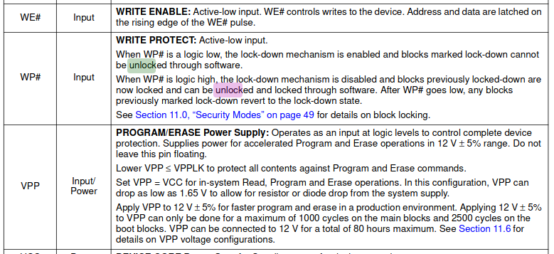

So this schematic got me looking... This doesn't seem right: [img:center] https://photos.app.goo.gl/tf78cj6XewCQWWU17[/img] and specifically, [img:center] https://photos.app.goo.gl/D3yvHt1ULpf9Wao88[/img] It looks like solder paste or some kind of cap leakage seeped under, but there are no obvious sources anywhere near it. I've flushed with 97% Isopropyl and then some DeoxIT D5 using a 0.3mm syringe and a wee bit of scraping. A flush and then blew it out with air. Looks better, but waiting for it to dry before try again. <some hours later...> Same result. Gets to 24% and errors. I don't know what that is under that first row of pins--it is not on any other device on the boards and nothing was ever spilled in there. I've been very careful to treat these with great care even when not in use. Maybe it is not related.
Edited by time (10/08/2025 04:23)

Re: Time to refurbish my MK2A.
[Re: gmarsh]
Posts: 14547
That's v1.00, an earlier version of the firmware blob. Is this a Mk2 "empeg", or a Mk2a "RioCar" ?

./download ../../../Downloads/car2-developer-v2.01-final.upgrade 10000 /dev/ttyS0 Waaaaait, you can't just use a whole ".upgrade" file with download.c... download.c is a fairly raw "rewrite this area of flash" tool, but an upgrade file contains several different chunks of data, some of which are meant to be written into blocks of the flash, some of which are meant to be written to disk. An upgrade file is bigger than the whole of the flash chip. The command you want is called "upgclient", though I'm not sure where to find it these days. Peter
Edited by peter (11/08/2025 07:27)
#374748 - 11/08/2025 07:31
[Re: gmarsh]
Posts: 4184
The "block is locked" errors you were getting, probably mean that the flash writing wrapped at the flash size, and only the write-protection was saving you from overwriting the essential early blocks of the flash, something which would have bricked the player. Well done "us" (actually it was probably before my time) for adding that failsafe...
